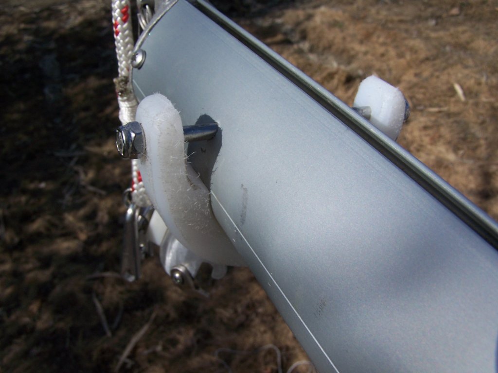

'The purpose of the winch is triple: As you mentioned, it helps to hoist the keel, but also to raise the mast and finally it could help to raise the sails. But it never serve to handle the sails. As I mentioned earlier I have design and install a hook that locked the halyard when sails up. An interresting feature with this hook is that it can work also with the reefing lines. I will be please to show how this hook is working but I will have to figure how to insert picture now (Tynipic is out of business).'

I took some pictures but how can I post it to this topic?
But axially my system is a bit different. There are some attachment going thru the mast at top and at each reefing line length. And then you have a hook that hols on those attachment both side of the mast groove. On each hook you find a small spur that will prevent the hook to catch the attachment when you raising up like the one you find on some ladders. Same principle on both side of the groove. For sure it will be better with a picture... but i'm sure that you understand the principle.

Would be nice to see your pictures Alex, your arrangement is still not all that clear to me!

Hi John! Thanks for the explanation. here are the pictures!

John Perry
- Posts: 105
Re: Halyard locks and reefing hooks
Hi Alex, thank you for the pictures which are nice and clear but I have to admit that I still don't understand how it works! I can see that the hooks cut in the sheet metal part will lock onto the cross bar through the mast and perhaps the 'small spur' helps to guide it onto the cross bar? But how do you then get it to release when you want to lower the sail? - and how do you tell it which cross bar to hook onto if there is one for each reef? I guess I must be missing something.
Hi John,
I know that is not easy to understand how this hook is operating. But be patient, in a few weeks or so I will make a small video for you. But the principle is often the same. You raise the halyard till the hooks clamp in a pin that go true both sides of the mast in front of the mast groove (actually in front of the mast bulkhead). So all the tension of the sail is spread to the mast via the dedicated pin. And when you want to lower the sail, you pull on the halyard again, disconnecting the hook and by doing so, the two side spur raise up and allow the hook to escape or free the pin. The main advantage of this system is that all stresses are taken directly by the mast and only half the compression load is apply on it. Also, there is no other rope involve than the halyard itself. So be patient and I will be back with a small video.
That's a nice system - and presumably it works with reefed sails by adding another (or more) fixed pin at the appropriate position on the mast.
Did you devise it, or is it a commercial system?
Hi Simon!
This is my own design, Feel free to copy it if you want! But if you do so, it will be easier to keep the pins perpendicular to mast longitudinal axis. I will be soon ready to send you a small video.
