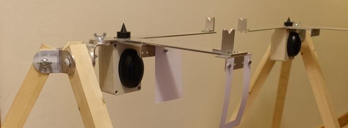

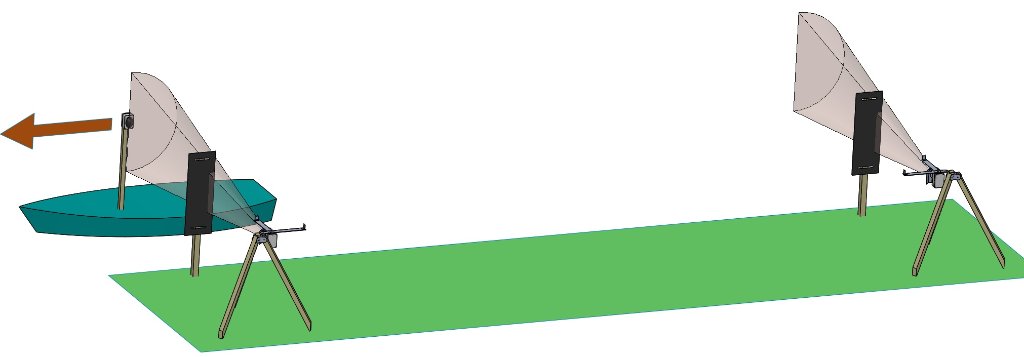

I have come to the conclusion that, based on specifications from receiver manufacturers, GPS speed measurement is not sufficiently accurate for drag measurement by towing. I have considered a couple of alternatives:
1) measurement of speed at a shore mounted winch that is doing the towing
2) measurement of speed by timing between start and finish lines which are defined by infra red beams.
I think both these methods have advantages, for the time being I have chosen to go with method 2). which can be used either towing with a shore based winch or towing with a towing boat.
The pictures attached show my proposed system. One picture is a computer drawing illustrating how the beams are shielded so that there is a sharp cut off as an infra red detector mounted on the boat under test passes each beam in turn. A micro-controller on board the boat under test measures the time between passing the beams and also data logs the tow line tension as sensed by a load cell. The second picture shows the current state of the actual hardware - at some stage I need to replace those bits of white paper with reasonably accurately cut sheet metal parts.
I plan to bring this system to our AYRS technical meeting in Surrey UK as scheduled for this coming Sunday - 3rd November - see program elsewhere on this website. We should be able to demonstrate the system during the meeting - we dont need water for that. I know Kim is also planing to bring some new hardware - he has been busy building a prototype beach rescue craft which sounds very interesting - it should be a good meeting - All are welcome ---
