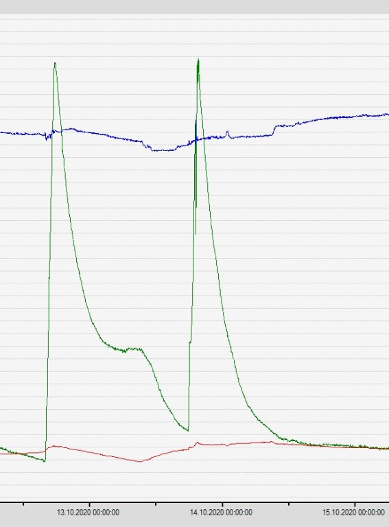

For sure I will be piercing the roof at a number of points. Knowing the dangers I will look closely after this points and sealing them. Having studied physics many years ago I'm a little obsessed with measuring and I own some equipment to measure temperature and humidity and use it regularly. So there will be e.g. the values of temperature, humidity and CO2 content of the inside air of the cabin logged and evaluated.
The attached curves coming from my "boat yard", a former garage the peaks are from CO2 concentration and checking the slope to the right of the peak I would be able to calculate the air excange (inside - outside).
